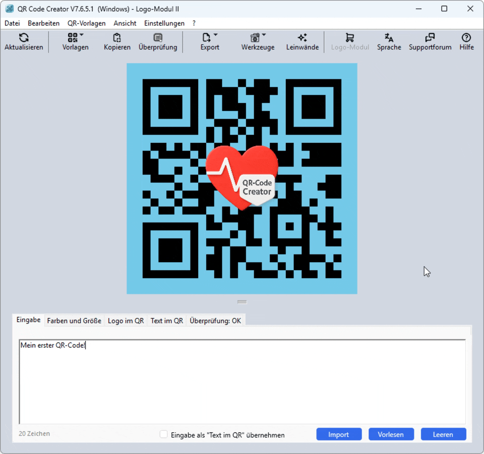

    Bug [7.6.5.0 (Lang: EN)]: Clicking "Empty" should remove the generated QR code.
    Steps to reproduce:
    1) Launch QR-Code Creator (QR-Code Creator.lnk/QR Code Creator.exe)
    2) In the main window, erase the default Input ("My first QR code!") or click "Empty"
    3) The generated QR code for the previous Input remains on-screen
    It will stay that way. Because I don't want to represent an empty grey area.
    Fixed with version 7.6.5.1
    I hope that with the latest version the reported errors are largely remedied. If you still notice something, please report here in the forum. I'm trying to fix this when it's possible and possible.
    Suggestion: Get rid of the default "My first QR code!" Input upon launching QR-Code Creator
    I had this at the very beginning, until we came here together with users and testers at the first view, which turned out to be practical and understandable for many users. Therefore, it will remain.
    It might be OK to have it for the very first launch ever but it's annoying to see it upon every re-launch
    Instead, maybe consider having no auto-gernated QR displayed (just a grey area) but set the focus on the Input so users can start typing
    You do not necessarily have to delete this entry. Once you use a different template, this view is directly overwritten.
    Thank you again for this detailed error analysis. This helps a lot to recognise such errors and then to be able to treat them accordingly.
    Please update to the latest version and test it.
